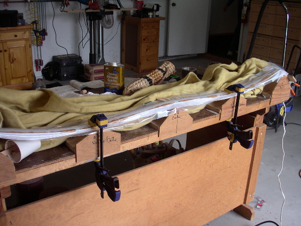

Lähetetty: 22.10.2005 23:31 Viestin aihe: |
Muotteja.
Description: |
Filesize: |
43.48 KB |
Viewed: |
12016 Time(s) |
Description: |
Filesize: |
80.5 KB |
Viewed: |
12016 Time(s) |
